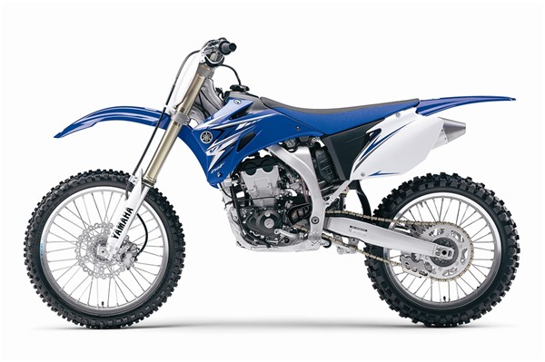

Q:WHAT’S THE DIFFERENCE BETWEEN THE YZ250 AND THE YZ250F?
A:The key difference between the YZ250 twostroke and the YZ250F is the engine. The rest of the changes are small setup differences in spring rates, chassis strength and geometry.
These changes stem from the fact that power output has a huge effect on how a bike handles, how the suspension works and what techniques the rider uses. The chassis must be compatible with the engine, and the rider must synchronize with the capabilities of the bike.
Q:WHICH BIKE MAKES THE MOST HORSEPOWER?

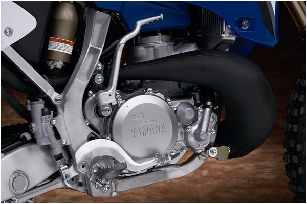

A:No comparison. A 2008 Yamaha YZ250F produces 36 horsepower at 11,300 rpm, while a YZ250 two-stroke makes 46.4 horsepower at 8500 rpm. That is a ten horsepower advantage at peak for the two-stroke.
Q:WHICH BIKE MAKES THE MOST TORQUE?
A:Pit pundits will always tell you that horsepower doesn’t matter as much as torque. They wax on about the torque advantage that a four-stroke engine has over a twostroke.
Guess what? A YZ250F fourstroke makes 20.1 foot-pounds of torque. Are you ready? A YZ250 twostroke pumps out 30.6 foot-pounds. For comparison purposes, a 450 fourstroke produces approximately 34 foot-pounds.

YZ250F four-stroke: In back-to back races with the YZ250, the YZ250F engine feels slow. The hit is less pronounced, there is no wheelspin, and the wiggle is reduced to a quiver. But the feel of the YZ250F in comparison to the YZ250 is misleading.
The lack of a sensation of speed isn’t the same as an actual lack of speed. The powerband may be down ten horsepower, but it puts everything it’s got into the ground. It can be chugged. It can be lugged. And it can be revved until the cows come home. The 13,500 rpm rev limiter and 11,300 rpm peak are about 3500 rpm higher and wider than the twostroke’s working spread.
The choice: There is no doubt that the slower feeling, but broader and higher-revving powerband of the YZ250F is easier to work with than the gun-and-run hit of the YZ250 two-stroke.

Q:WHICH BIKE IS EASIER TO MAINTAIN?
A:The two-stroke naturally goes through tires, brakes pads, chains and sprockets a bit faster because it makes more power. But the complexity of the four-stroke engine makes it an expensive proposition to live with. It needs oil, oil filters and eventual valve work that the two-stroke can do without.
Q:WHAT ABOUT ENGINE REBUILDS?
A:Puhleeze! Two-stroke engines are easier to rebuild, have fewer parts, and the parts cost less. That recipe means that you could rebuild a YZ250 three or four times for the cost of one rebuild on the YZ250F. Don’t even think about the cost of a catastrophic failure on a four-stroke engine.
