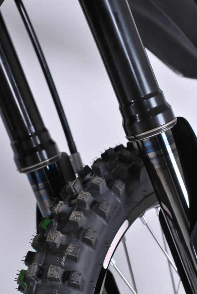

ForksCombined with top quality, CNC machined triple clamps, the beefy upside-down front forks by WP Suspension with 43mm down tubes ensure a great response and damping, as well as providing the FREERIDE 250 R with outstanding stability. Their stiffer basic set-up perfectly matches the re-tuned rear WP monoshock which receives a new, progressive spring. While preserving the excellent ride comfort, front and rear suspension of the FREERIDE 250 R are markedly well balanced and very well protected from bottoming out – an advantage especially in quicker sections in demanding terrain. Damping is separately adjustable for compression and rebound, while the monoshock even has separate low and high speed controls for the compression stage. For those who would like a still lower seat height than the FREERIDE 250 R’s comparatively low 915mm, the KTM PowerParts range offers a lowering kit, reducing suspension travel by 25mm.
