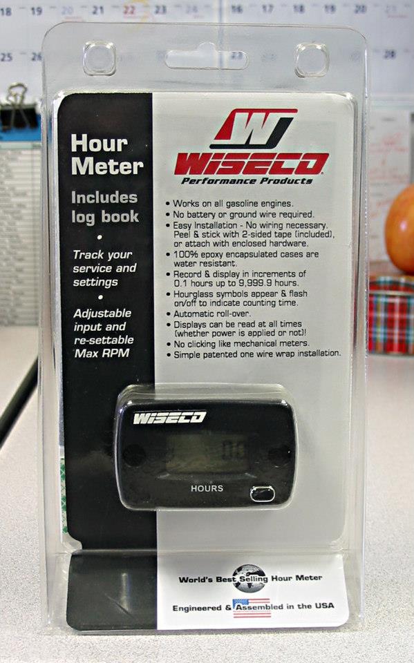

First you will need 3 things
1. An hour meter,
2. A piece of paper to track your practice/ race days and engine hours.
