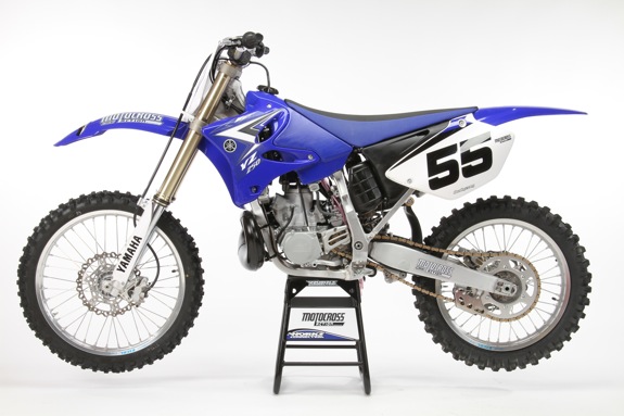

    The MXA wrecking crew has tons of two- and four-stroke experience, so it was only natural that we would answer the question that every AMA Amateur is asking. What’s better? A YZ250 or YZ250F? We chose a Yamaha-versus-Yamaha comparison because that was the best way to eliminate any handling, suspension or component issues.
Q: WHICH BIKE COSTS LESS?
     A: In 2011 prices, the Yamaha YZ250 retails for $7450 and the YZ250F clicks into the cash register at $7150. Surprised? You shouldn’t be. Yamaha feels that they have a captive audience when it comes to two-strokes—thus they have no need to run bargain prices.

    Q: WHAT’S THE DIFFERENCE BETWEEN THE YZ250 AND THE YZ250F?

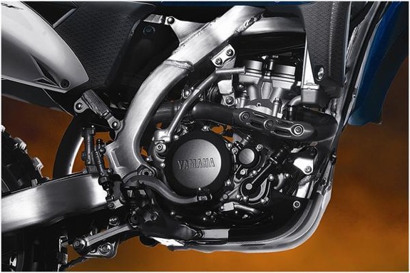

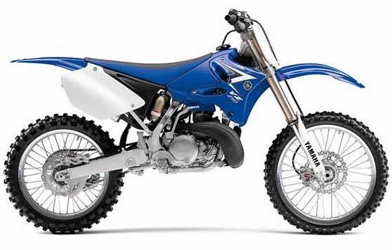

     A: The key difference between the YZ250 two-stroke and the YZ250F is the engine. The remainder of the changes are small set-up differences in spring rates, chassis strength and geometry. These changes stem from the fact that power output has a huge effect on how a bike handles, how the suspension works and what techniques the rider uses. The chassis must be compatible with the engine and the rider must synchronize with the capabilities of the bike.
 Q: WHICH BIKE MAKES THE MOST HORSEPOWER?
     A: No comparison. A Yamaha YZ250F produces approximately 36 horsepower at 11,300 rpm, while a YZ250 two-stroke makes on average 46 horsepower at 8500 rpm. That is a ten horsepower advantage at peak for the two-stroke.
