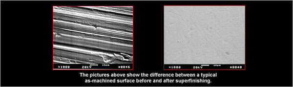

This process begins with superfinishing all parts before the coating is applied. This removes the peaks created during the manufacturing process, therefore changing the surface profile of the metal. It’s easiest to equate this with a rock versus a skipping stone, a smooth stone skips best.
