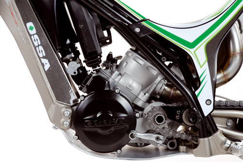

The fact that the new TR 280i incorporates a system of electronic injection it has allowed its engineers to redistribute different elements without being in favor conditional of the position of the classic carburetor. “Sometimes the injection system has been placed in the same space in which it was the carburetor, with the fuel tank in the high part of the motorcycle, without considering the option to look for a new positioning. OSSA Factory has let start off to me of zero and this one has been a determining aspect at the time of initiating this project” points Xiu.
The situation and ideal configuration of different elements have given like result a very small motor with the inclined cylinder backwards, the intention to be able to locate in the high part of the TR 280i the system of injection and the filter house. The same logic that other manufacturers apply in specialties like cross or enduro, in OSSA considers that it is perfectly valid for a specialty like the trial.
ossa_009p
The new motor, of 2T, is very compact, with the case of a single piece. The change is extracted straight from lateral and the crank by the opposite side. Considering that the case for of chassis, for the being has been leaving resistant from the set, has been able to make a block compact. Of this form the possibility is simplified of acceding to the change relations.
Another important aspect is that the maintenance is economic since to manipulate the propellent is extremely simple. A conventional motor as far as geometries can be considered or thermodynamics but has obtained an extremely compact set like concept. It is of the smallest motors of the moment.
The fuel tank of three liters of capacity has been placed in the place where conventionally the trial motorcycles mount the radiator to improve the distribution of weights. The equipment of OSSA Factory considers that the more light it is a trial motorcycle, the more necessary turns out to have the advanced center of gravity.
When placing the radiator behind the deposit and the filter house, is avoided something so habitual in the specialty of trial because the radiator is covered with mud, with the consequent problems that entail the fact that the motor cannot work to the appropriate temperature.
OSSA__5_
A motorcycle without movement (stopped) has to have the capacity to dissipate the heat of the motor and to mount a electroventilador like in the TR 280i. Therefore, although in a motorcycle of another specialty it would be necessary to apply fresh air canalizations, in a motorcycle of trial no. Since the own fuel tank protects the radiator, the new TR 280i can work to a constant temperature, without being conditional to the possible dirt of the radiator.
On the other hand, to invest the cylinder has allowed to practically mount the admission in vertical after the fuel tank, and so the air intake through filter is located more in one of the elevated points of the motorcycle. Therefore, the watertightness of the filter will be superior and the access to the own filter, very simple through a cover. In the interior, under this same cover, some elements of the injection system will be placed. In this location the components will be affected neither by the temperature of the own motor, nor by the humidity.
In the distribution of the elements of the motorcycle one has considered very the temperature to which will work each of them. When having the inclined cylinder and mounting the escape backwards, from the back monoshock absorber can be defined the escape, whose volume is superior to the one of a conventional motorcycle.
